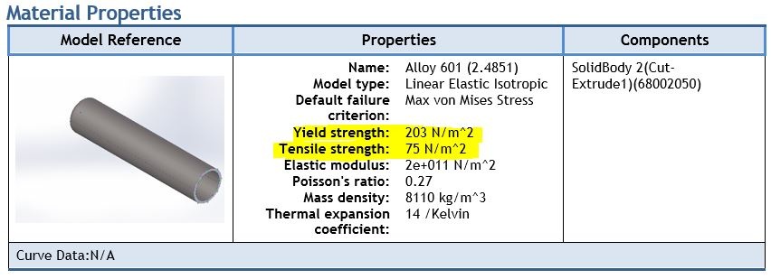

The Word Report generated by SW2015 Simulation are with different values then material properties used in my model!
I have no idea where these values come from. Why is this difference? With which values are now calculated?
Model: Tensile strength 741 N/mm^2 (Mpa) & Yield 290 N/mm^2 (Mpa)
Report: Tensile strength 75 N/m^2 & Yield 203 N/m^2
Note that also the units are different N/mm^2 (Mpa) versus N/m^2 (this is a 10^6 difference)
