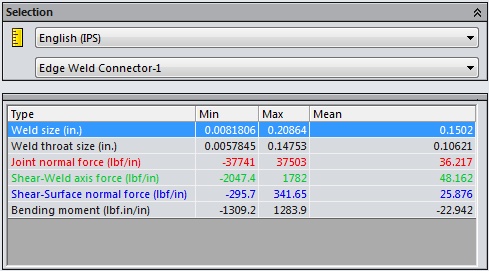

The Simulation FEA results seem to be much more conservative than hand calcs from Blodgett - Design of Weldments.

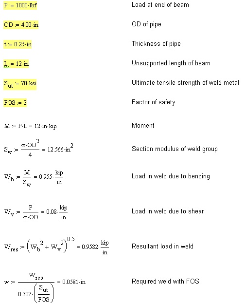

Hand calcs = 0.058"

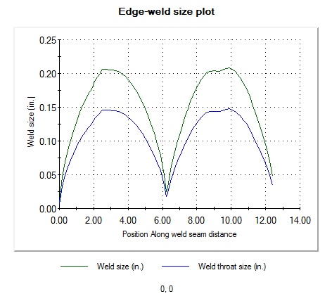

FEA = 0.208"
See below comparisons. Does anyone see anything amiss in my set up?

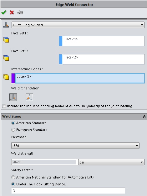

I am assuming the E70 (SUTS = 70 ksi) electrode is divided by the safety factor of 3.

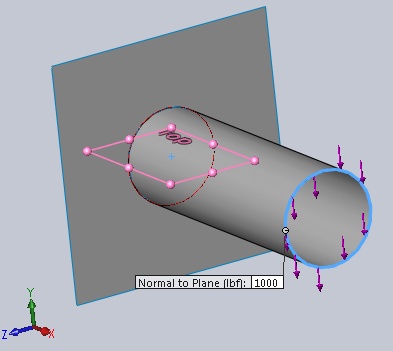

Note: In the FEA, the pipe wall thickness is 0.25" and the plate thickness was considered to be 10" x 10" x 2"  thick (rigid).
Hand Calcs:
Reference: Section modulus of a circular weld group from Blodgett:
