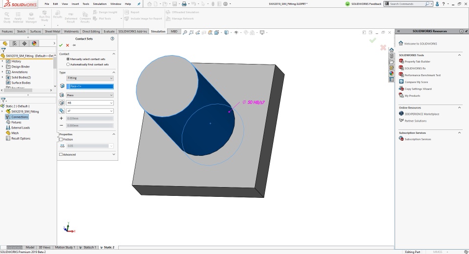

For example like this:
But for the Simulation you need to have the size of the fit.
In that case the dimension is 50 H8/s7, so you need to make the hole between 50.000 / 50.039 mm and the shaft 50.043 / 50.068 mm.
To get now min and max stress you need to run at least two studies
Or what would you say to a new option within the "Contact Set..." like "Fitting".
Once you activated it, you just need to select one face of the fit contact and adjust the settings
As a result it would be great to get min, max, mean, ....
