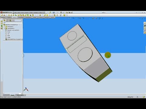

I have a model which contains various short edges and smallfaces, this model relied heavily on Lofted Cut features, on certainareas of the model this has generated some small faces and shortedges.
I've gotten the very helpful tip on these forums before, aboutusing "Delete Face and Patch" to remedy small faces and that almostalways works great!
However for short edges I haven't yet found a "golden" solution,other than trying to painstakingly alter my underlying profilesketches and guide curve sketches - which by the way are all fullydefined and coincident or pierced - so... let's forget aboutthat for a moment
I can have SolidWorks find all the short edges with the "Tools-> Check" feature, which is great, but now I want to merge thoseshort edges somehow.
I took some pictures to clarify.
Themodel
Theproblem area with short edges
Zoomedinto that area to see the individual edges I wish to "merge"
