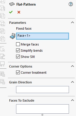

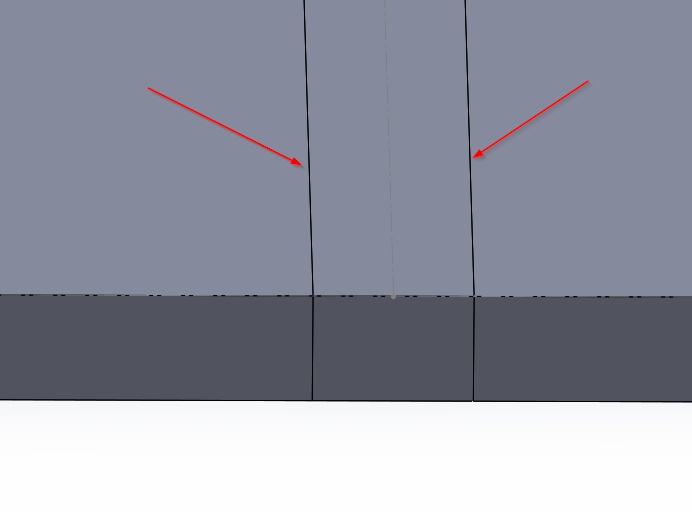

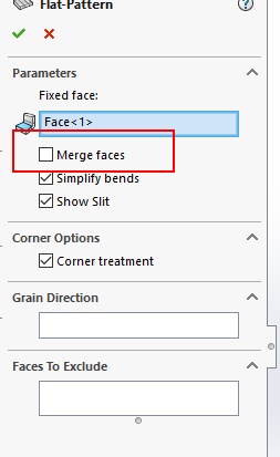

In sheetmetal when you turn off " merge faces " in the flatpattern options  you get the begin and end of the bend. This is usefull when you export a sheetmetal product thats needs to be rolled.
The trick is that we want those lines to be on a different layer then the geometry ( atm its becomes part of the geometry export)
Is there a way to achieve this with api ?
