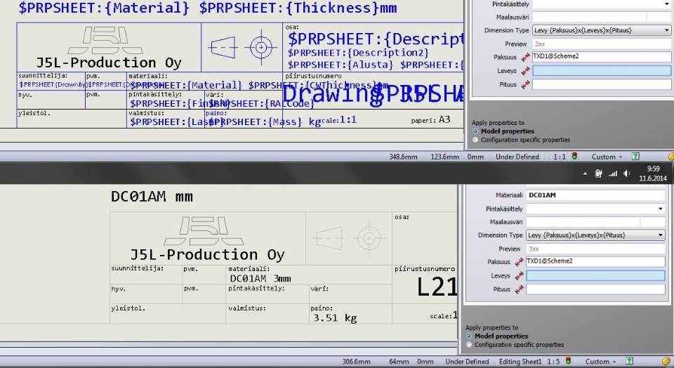

I have a software where i enter the CWThickness property into part, and it is shown in the drawing sheet I made like this:
You can see the materiaali: DC01AM 3mm is shown correctly.
You can see the materiaali: DC01AM 3mm is shown correctly in lower title. When I tried to use simpy the Thickness property above the title it does not show up. Can I directly use the sheet metal thickness like this?
Only problem with this is that I need to enter some dimension to get the CWThickness property, and it is always the same as sheet metal thickness of course. So the value shown in drawing title could be same as Sheet Metal Thickness value.
