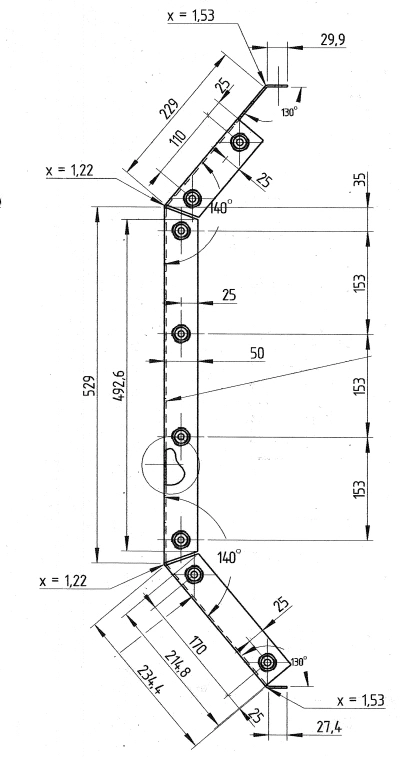

How can I model such a sheet metal part as quickly as possible, so that its main frame is created using a single sketch and a base flange (this seems to be the fastest method)? I usually follow the approach shown in the pictures below and use the base flange feature, but unfortunately, after this operation, the dimensions do not match those defined in the sketch. I always end up having to adjust the values manually, which is very time-consuming. For example, I set a dimension of 529 mm in the sketch, but after the bend is applied, it becomes 527.18 mm – and that's where the trouble begins.
Is there a way to get the exact desired dimension right away, such as 529 mm in this case? Or is it always dependent on the sheet thickness and bend radius?
In this case:
Sheet thickness = 3 mm
Bend radius = 2.5 mm
