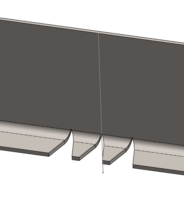

I have a box that my customer wants to have formed as a single piece. The problem that I have is that I can't seem to get Solidworks to play nice when it comes to adding mitered cuts to the corners as seen below:
This is how we have successfully fabricated it in the past:
The guys will then form the flange like this:
Then they will hit the piece with a 2" radius die that will close the pie shaped wedges and the piece will form correctly. However, we have never been able to get the appropriate developed length or burn pattern due to the fact that Solidworks doesn't seem to be able to form the last step. This model was created using a base flange that was cut manually and adding a sketched bend (the grey line), but the first picture was modeled as a swept flange. I am stumped so far and wanted to see if anyone else would have a fresh eyes solution.

Looks like your last step you're trying to do a sketch bend?  Can you do 3 sketch bends at 30° instead?

I hadn't tried that. The Break Operator will be using a single break operation with a 2" radius, so I was trying to model it as close as possible his conditions. I also think it may be struggling with 2 different bend radii. I have a 2" larger radius and a 1/4" smaller radius.

Solidworks will not let you create a bend across another bend, as said before you will need to do 3 sketch bends on a flat area.

The flat pattern will be a rectangle with 2 "pie" cuts side by side like this picture:
I know this to be true because we have made the box several times, but the previous designers simply "faked it" in Solidworks (sketch lines on the drawing) and let the shop person figure it out. Out in the shop, it is a single 1/2" radius die hit on the horizontal line followed by a 2" radius die hit on the vertical line. The box forms up nicely... in real life. In Solidworks, not so much. It would be great to figure this out so that when someone asks for a different sized box, I can get the development without too much hassle.

I was able to come up with this you can fold unfold the part, you can't flatten but it does export a dxf. this was done with no regards to size except .25 and 2.

Chris,,, I'm not sure if this will help you with your particular situation but you can unfold the "Swept Flange" and make your cuts. You would have to figure your point to point distance on the open end of the V cuts (angles) in order to make sure that the cuts in the flange would not crash when folded again. I say that because SW does not take into consideration that that area is cut so it will compress the outer ends of the cut when formed. You can see in my screenshots how much they have compressed which is not what is going to happen in the real world using a press brake. If you need the formed model to be accurately presented you would have to fill that in (different config).
I just eyeballed the v cuts to look similar to your screenshot.
Edit:.. Now I see that the point of your triangular cut are just above the bend line.
