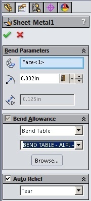

Here is the bend allowance asetting that goes back to k-factor when the above code is run for a part created in sw2013 or sw2014.
