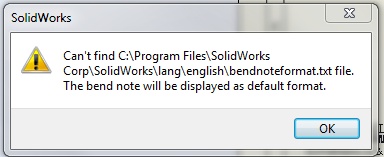

The problem I am having is when I am adding in my flat pattern drawing view it is auto creating a new config derived from the flat pattern with the suffix "SM-FLAT-PATTERN" and using that config in its place.
Before it replaces my flat config with the SM-FLAT-PATTERN I am getting this error message:
Are these configs being auto created because I have not set up the bendnoteformat.txt?
My current solution to this problem is to change back the config to my original and to keep my model tidy I am going through and deleting all the new SM-FLAT-PATTERN configs which is terribly time consuming.
