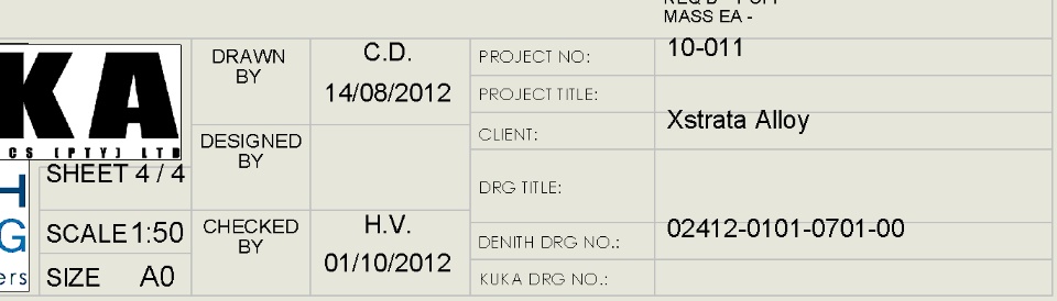

Hi,

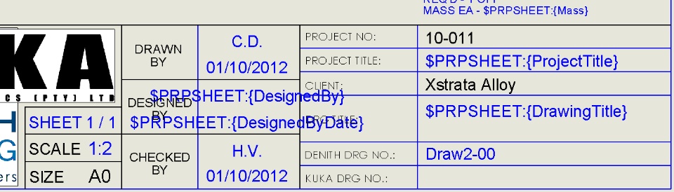

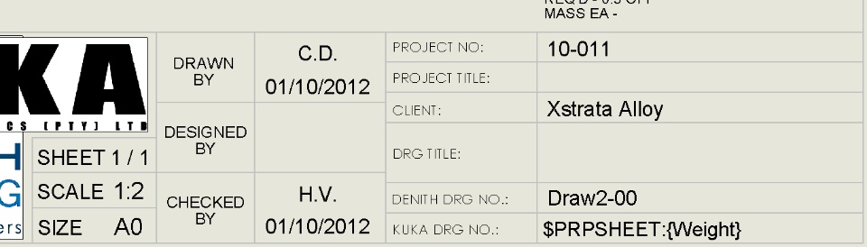

I've made a few templates but I'm having trouble with the vertical alignment of most of the elements. After aligning everything and saving the sheet format, when I apply the sheet format to an existing drawing, or open a new drawing with a template that uses the sheet format, many elements are shifted up slightly. See pictures below, where the 3rd shows the vertical shift.
I can't see any way of fixing these elements onto the page, and while making blocks worked for some static text they seemed to destroy custom property links. However, simply adding shifting elements to a block also shifted them from their previous position.
Any ideas on a fix or workaround?
