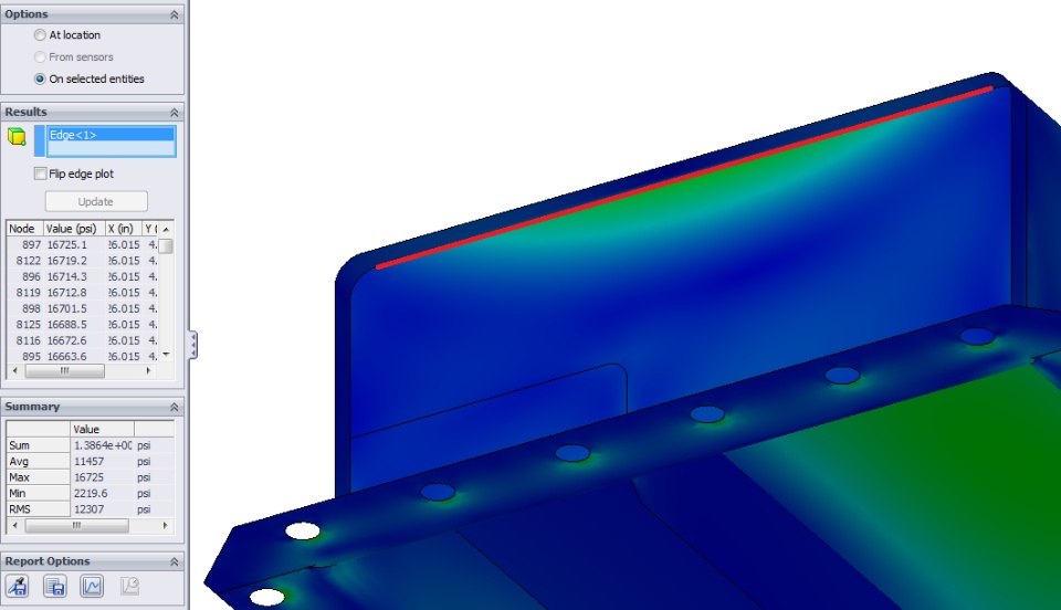

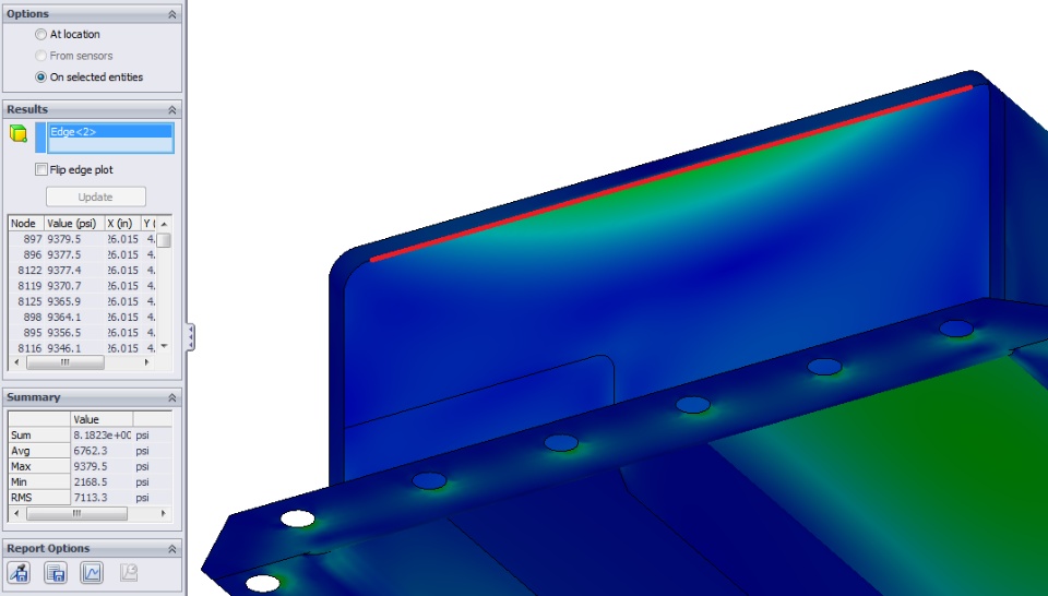

I have a shell model where two perpendicular edges intersect at a shared edge with nodal bonding. When I deselect "average results across boundary for parts," I see that I can get two different sets of stress readings at the shared edge depending on which edge I select to measure.
I'm just curious how to interpret this. If I'm measuring nodal stress results, shouldn't there only be one set of stress results along a shared edge?
The attached images show the same location being measured, but I selected the two edges. You will see that the same node numbers are listed, but displaying different stress readings. Again, this has "average results across boundary for parts" unchecked.
