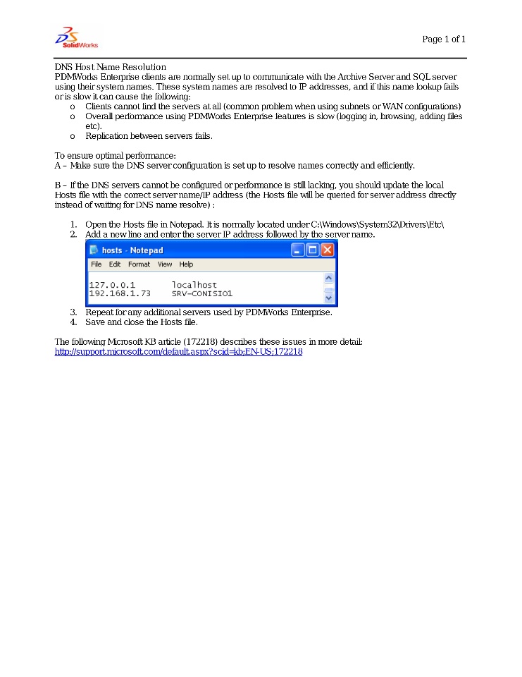

But, I want to set up EPDM on Windows 7 machine, tieing into a 2003 Server where I have the Archive Server and all the Server side stuff set up. I have several XP laptops already set up and able to access the vault from these laptops, however they are part of domain, let's call it wayne.
My 7 laptop is part of 'white' domain. I can RDP into the server and ping it with success but I can not login to the vault.
Is this because I am part of a different domain?  I'm not very good when it comes to network stuff, but I can't seem to simply change the domain of my 7 laptop to simply make it part of 'wayne'.
Any ideas, thoughts, suggestions?
