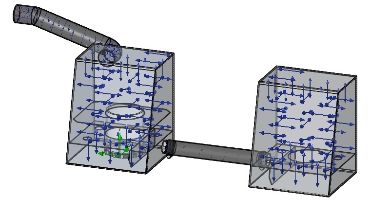

The situation is as follows (see also the picture):
We have an empty fuel tank, which consists of two tank halves. So in real life there is only air in it. The fuel tank is filled through the filler neck with a constant volume flow. This is boundary condition one (hard to see in the upper left).
     When running the simulation now, I got the error message from the last post. So I put on all inside surfaces a boundary condition with environmental pressure. The fuel cap is open at this time, so there is an ambient pressure in the fuel tank I guess. Am I right here?

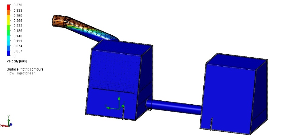

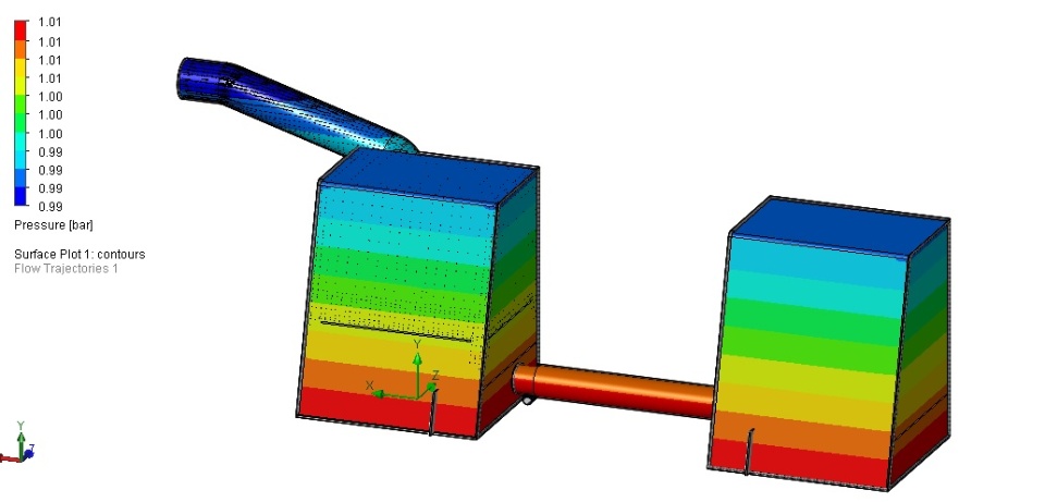

When I run the simulation now, I don't see any decrease/increase of velocity or pressure when contacting the tank baffles and at the connection. (See pictures) Only at the filler pipe I see a decrease in velocity. Also is the velocity much lower at the beginning of the connection instead of mine calculated value. The surface plot of the pressure looks also really weird.
I'll hope anyone can help me with this simulation. I would like to simulate the influence of the fuel baffles on the filling of the fuel tank. My goals are to determine the pressure drop over the connection and the volume flows/velocities at the beginning and end of the connection hose.
