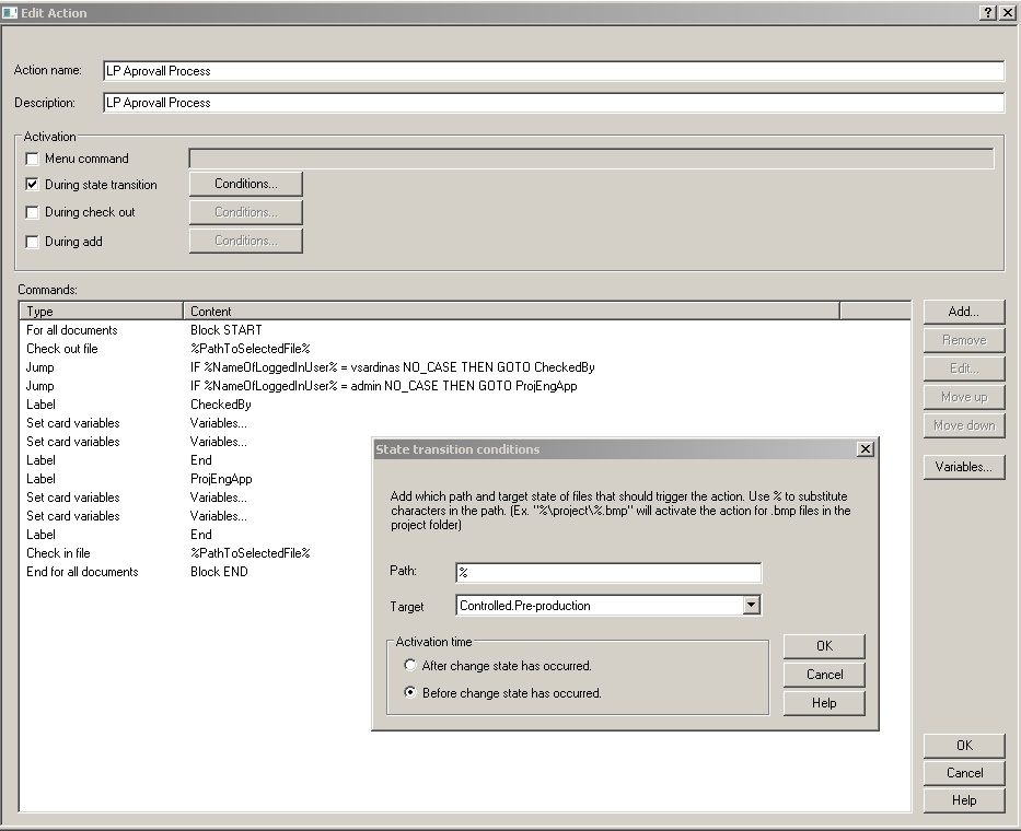

1. Using A Parallel Transition to get approvals in Workflow
2. Using Dispatch script to test for user and transfer to data card

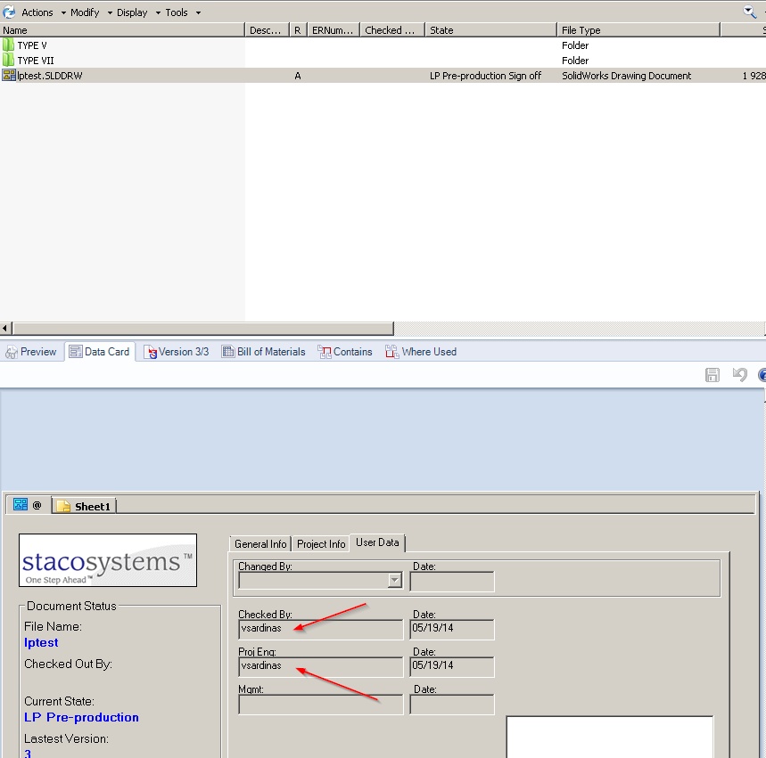

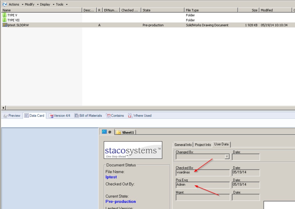

If CheckedBy goes first, data card will look like Drawing Card First Signature, then Drawing Card After Second Signature is how the card should look (correct), but if admin goes first, admin will be on both fields, and CheckedBy is ommited.
I thought if I used the jump command with a LABEL, it would go to the right section in the program. Not sure what I am doing wrong.
