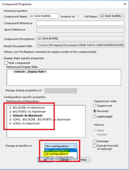

i would like to add a component Reference for all configurations of an assembly of a selected component via SWX VBA API.
Adding the Component Reference in one assembly via macro already works:

How do I set "All configutations" via API (see yellow marking in the picture)?
