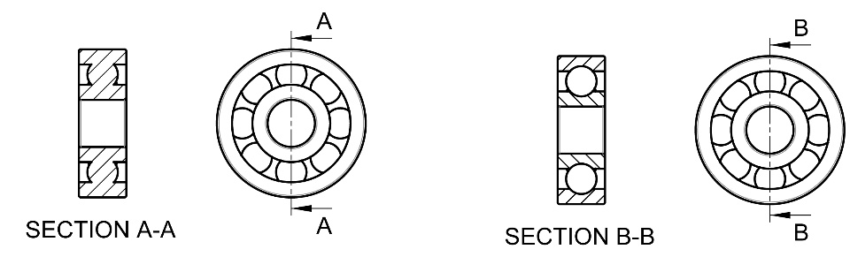

When I use a roller bearing from the toolbox and make a section view for a drawing i get the view you can see in Section A-A
but according to normalization I need Section B-B. (see attachment)
Isn't it possible to change this in the toolbox, so no merging between the features, but seperate bodies for the inner and
outer race and the ball?
Would be appreciated not just from me.
