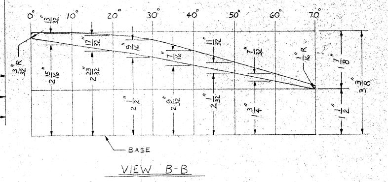

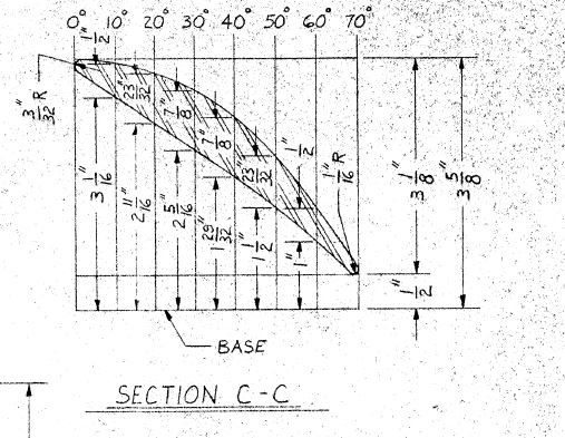

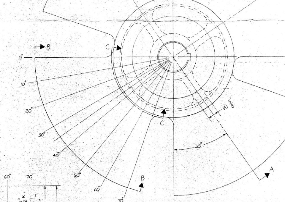

I have a need to create a drawing of an impeller that we have in house that is very similar to another impeller that is produced from a hand job drawing created in 1987. The hand job drawing has 2 section views (Section B and C) that show the impeller blade cut in a radial manner so that the Francis vanes can be defined for the pattern shop. (See the image).
After looking at my options in Solidworks, it doesn't look like Solidworks gives the opportunity to make a section view that is cut along a radial path. Is there a way to get this type of view? Or do I have fake it in?
