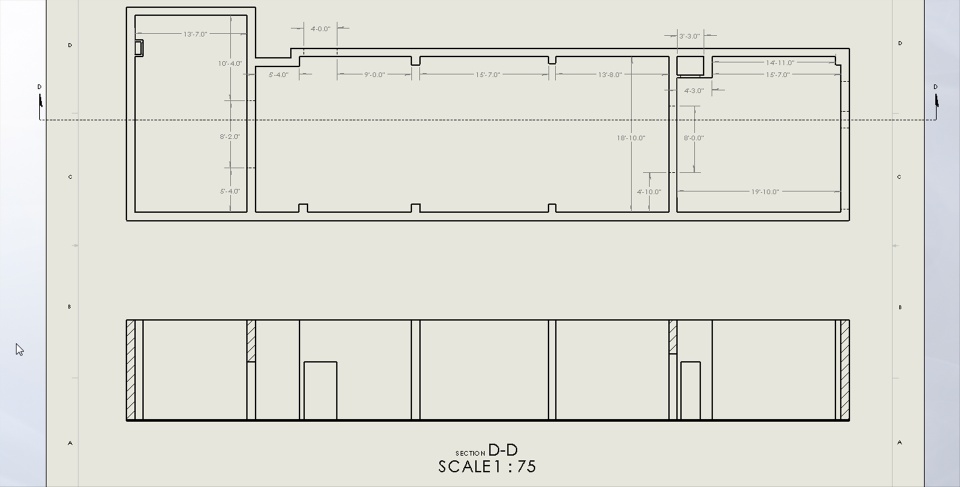

Section View - Cut line falling off page and handles do not work
So, I've upgraded to 2014 with clean install to make sure all is good. Working on a small building layout and have to do some section views. Wentto place section view into drawing and the view is okay but the section line with designated letter assignment falls off sheet. Figured no problem, click the line and grab the handle and drag back onto page........not happening. Checked the properties to see if I'm missing something on this but can't seem to find anything anywhere that might be a setting that helps me to make this adjustment. Any ideas?
Here is a screen grab to show the section line and arrows off page.
