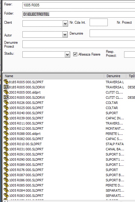

I have an assembly containing the following information in the textbox "Description 1" on the datacard(Green square):
565 3228 511 258 658 (Red square)

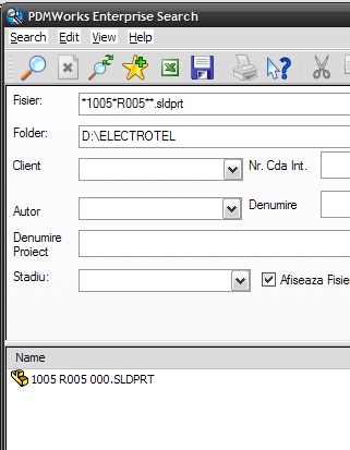

Now on the search card designed in PDMWorks(Orange square) I can search for text in "Description 1"
If I type "565"  in the "Description 1" (Blue square) on the PDMWorks search card, I can find the part without trouble.
But I want to be able to type in "3228 658" in the text box "description 1" on the search card, and find the part.
If I want to use more the one "word" for searching I need to remember the correct order that I type the "word" in the datacard.
I just want to be able to search for more then one word from a text box, is that possible?
