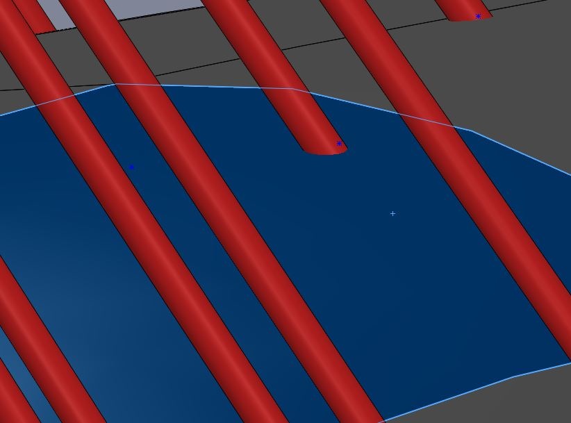

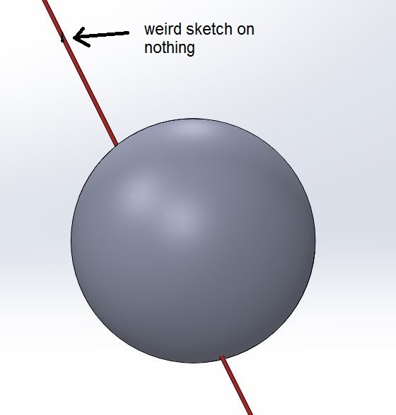

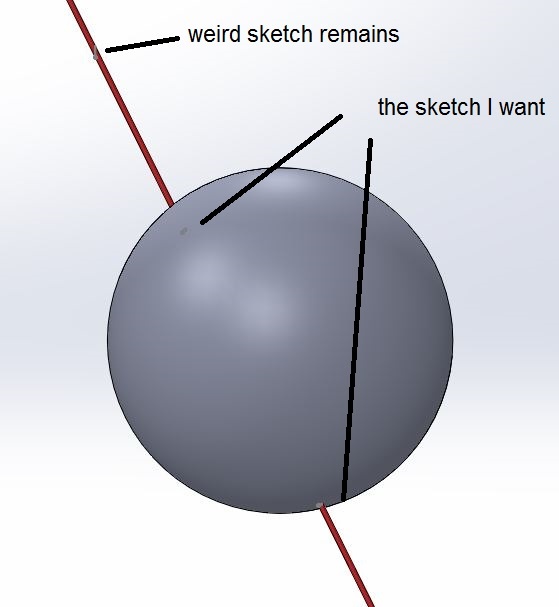

I used tools->sketch tools->intersection curve to record a macro and selected the two bodies that I need the intersection for. this works somewhat strange as the first time I use the macro that I recorded I get a 2d sketch on seemingly nowhere (picrture 1). after I exit this sketch and rerun the macro a second time I get exactly what I need. (picture 2).

any thoughts as to what's causing this?
