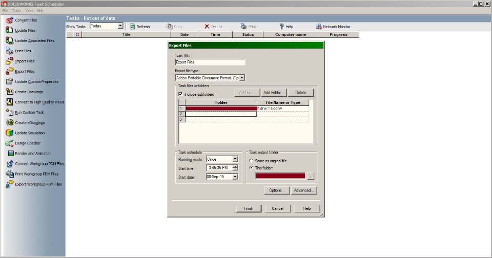

I have been trying to use the task scheduler to export a batch of .DWGs in a folder to pdf.
Following how I had managed to do so in SW2013's task scheduler,
I would click on "Export files" in the left column, choose my target folders and output format,
and set the time about a minute or 2 ahead of the current clock time just in case.
In SW2013, the export task would run and while running, show task progress.
However when I tried to do the same in SW2015's scheduler, the scheduled task would just sit there perpetually and not run, even after the chosen time arrives.
I do not know what may be wrong, but I did notice that the date that I choose is always different from the date that is eventually assigned to the task.
From my observation for days up to 12, the day and month get swapped.
What can I do about this?
