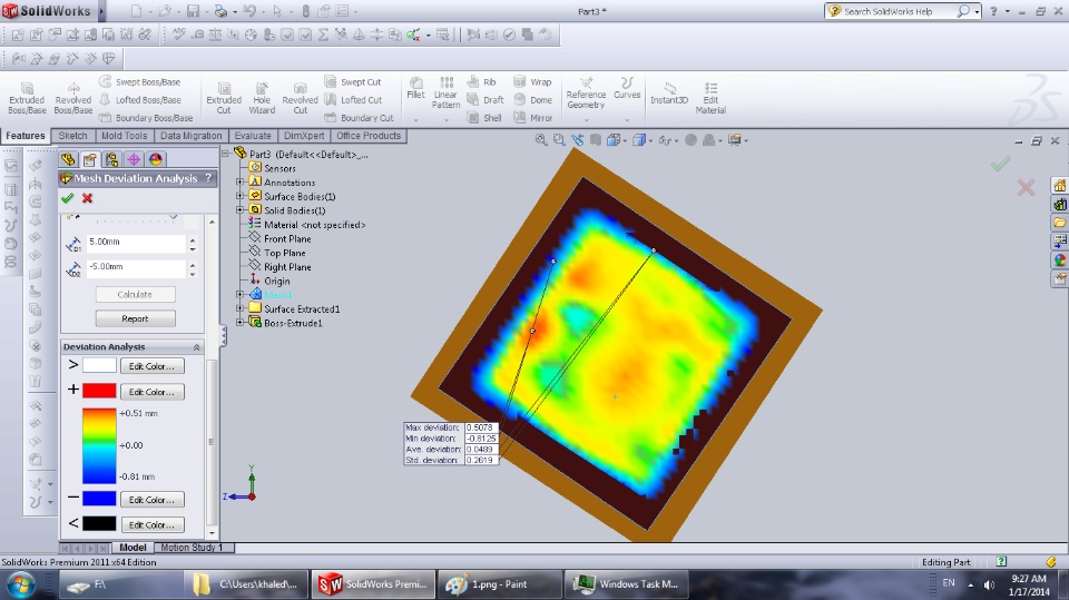

2. Using Surface to mesh deviation type in the Deviation Analysis in ScanTo3D Add-Ins, Sometimes graphical outputs don’t have a good quality especially in edges. For example:
or this one
Has anyone suggestion to solving this problem?
