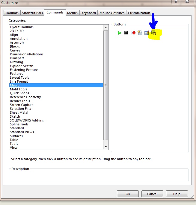

Attached is a Macro written by that I use every day - Just click on the view and hit the Icon and it's done, when selecting a detail view of section view sometimes you need to hit it twice..
I attached two different scale Macros, then you can see where you need to change the macro and save it as another scale. You need to create .bmp pictures of the scale, I have one attached as well.
To add them in your View layout tab you need to go to the Customize Menu and select:
