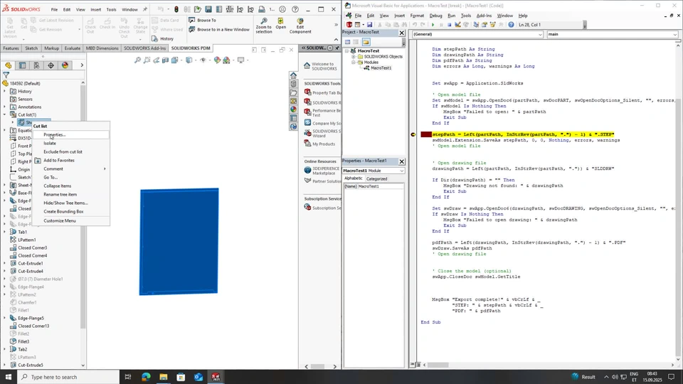

I am running the same macro on multiple computers, but I am receiving inconsistent results. On certain machines, the macro appears to reset file properties to 0.00000 immediately after saving the STEP file.
Computers are similar: Windows 10 or 11, same SW 2023 SP4, tried sharing SW settings.
An example macro:
