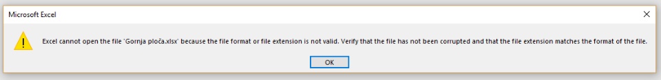

After closing the parts, the design tables are saved from SolidWorks. When I try to open them in excel after I get the following error:
