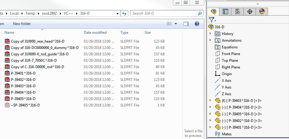

Saving assembly into vault is generating serial numbers for virtual parts
When an assembly with virtual components is saved into the vault (via Save As) serial numbers are being generated for the virtual components.
Is there a way to prevent this? After the save is completed the components remain virtual in the vault and this is burning through out part numbers.
As you can see from the screenshot of my temp folder, the "Copy of..." have all been renamed.
