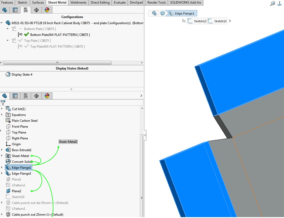

I have 2 configurations Top and Bottom plates. Both of them use the same edge flange parameters defined exactly the same but when flattened, the bottom plate looks like this:
But the Top plate looks like this:
Notice the difference in the reliefs applied.

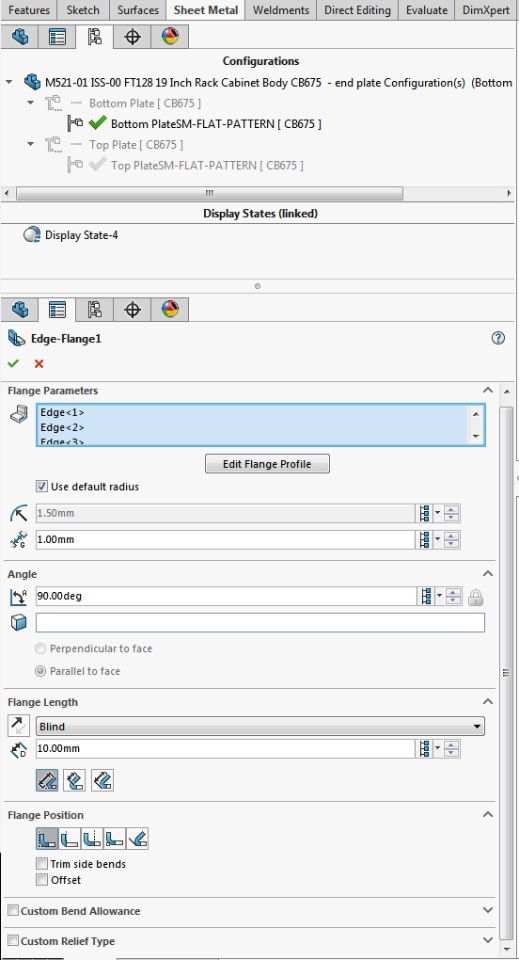

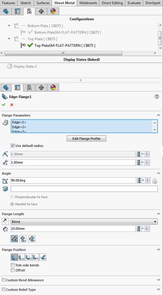

Both edge flange have the same parameters applied:
Top flattened:
Bottom parameters:
Both have the same parameter (obviously since they are used in the configurations), so why are they different when flattened?

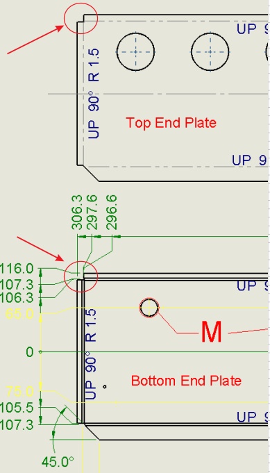

It also shows up in my drawings:
