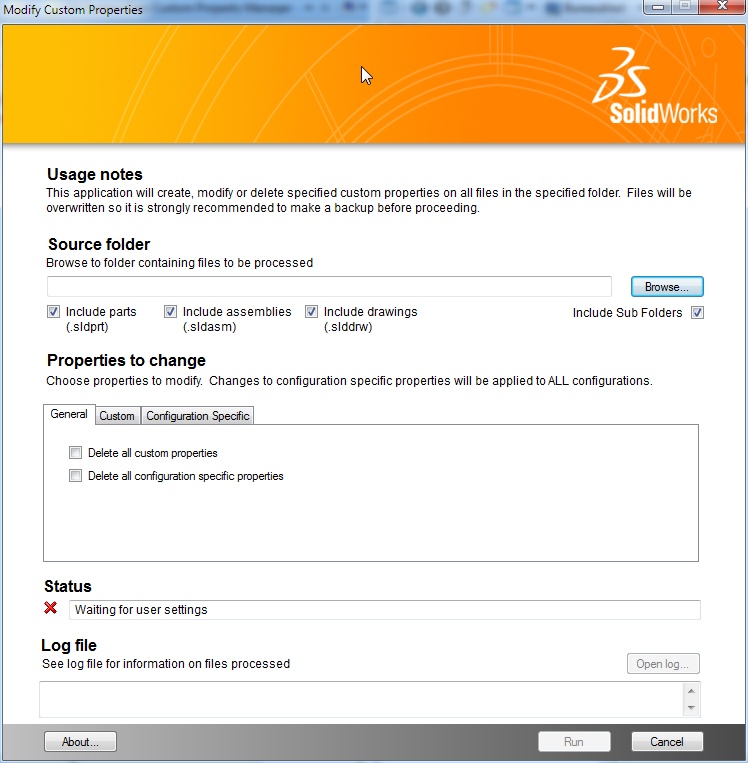

My tip for now: A great tool for add/ delete or changing custom and configuration specific properties is the 'Solidworks Custom Properties Manager ' see pic.
'This application will create, modify or delete specified custom properties on all files in the specified folder.  Files will be overwritten so it is strongly recommended to make a backup before proceeding.'
