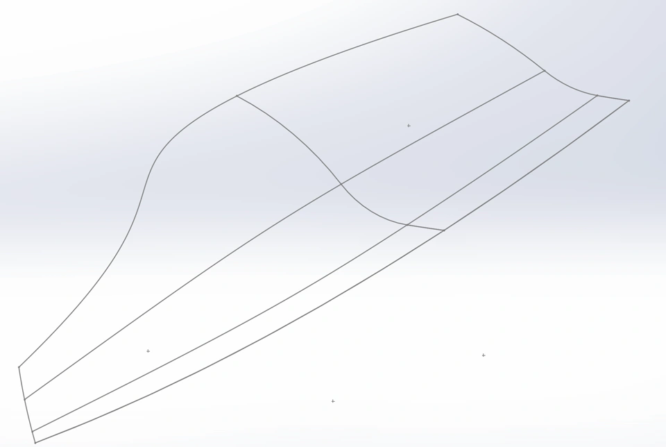

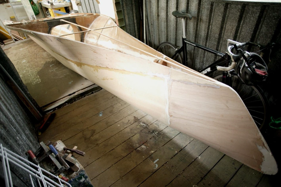

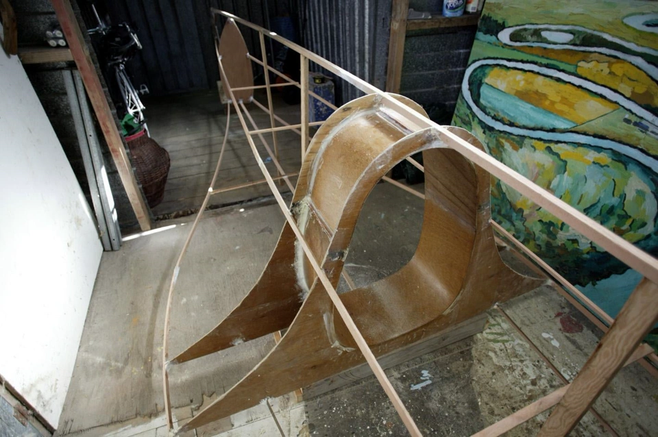

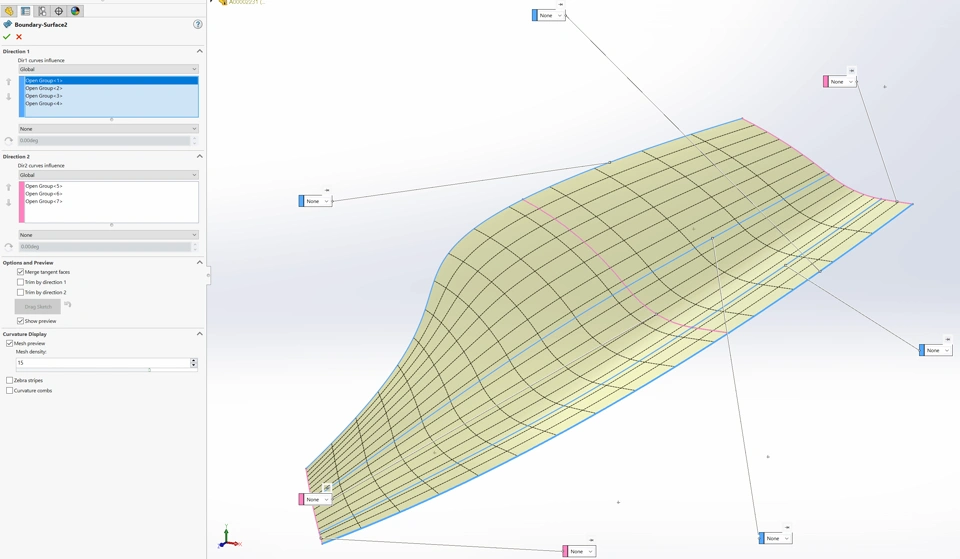

Hi, I am designing a boat hull in SW, to be built by bending a single thin plywood sheet against several frames and stringers (as few as possible), like this guy:
The shape, while very complex for hydrodynamic reasons, needs to be designed in a way that makes it developable (meaning the plywood would naturally follow this shape when pushed up against these few bulkheads/stringers), rather than forcing it into an un-natural shape, which would require far more bulkheads and likely make the surface distorted.
To my understanding, this means that the surface should have as little compound curvature as possible, to minimize stretch and compression. However, that alone probably does not guarantee that the plywood will follow the exact intended shape. It's almost as if this should be designed the other way around - figure out how the plywood would want to behave naturally when butted up against the frames, inspect the resulting shape, and tweak the location / number / shape of the frames until the surface is of the shape you need. However, I have no idea how to implement such a workflow in SW.

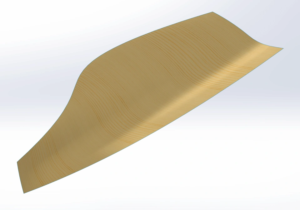

I designed a similar shape in SW using Boundary Surface, assigning Global curve influence and no C1/C2 constrains to make the surface flow as naturally as possible:

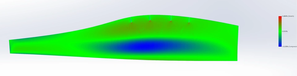

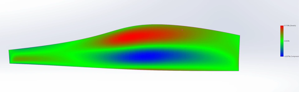

And the flat pattern I get is this:
0.170% stretch and -0.237% compression, indicating that I failed to avoid compound curvature. I actually tried including some darts (relief cuts) into the upper edge that gets stretched, but weirdly enough this only increases stretch/compression percentage. I suspect this is because SW creates flat patterns through meshing, and these are just spikes at the sharp corners of the darts, similar to sharp corner singularities in FEA simulations. This does make it difficult to evaluate if darts actually help or not, since the colors are relative to the min/max stretch.
That is as far as I got. Can anyone share any advice on what rules/workflows should be followed to achieve developable surfaces that will naturally conform to the desired shape with as few bulkheads as possible? Yes, I know that if I loft/boundary with just single direction curves (or straight lines) that will result in fully developable surface, but it would be way more primitive than what is needed here. The example of that guy's pics shows that this is possible to achieve even with very complex shapes, but they have to be designed just right.
Looking forward to your advice!
