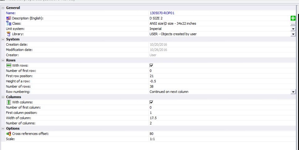

Row numbers doesn't increase even though continues on next column even though Continued on the next column option is selected  in the title block properties.

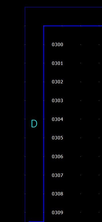

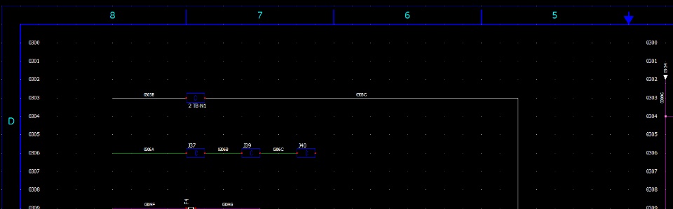

Here the starting Row number has 0300 [FILE_TAG +STRZ(VAL(ROW_ORDERNO), 2, 0) ].It continues up-to 0337 then on the second column it starts from 0300 instead of 0338.
Error image:

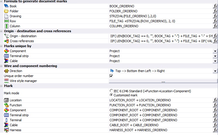

Current project formulas that I am using.
I want the second column to start with 0338 instead of 0300.Please help.Am i missing something very obvious here?
