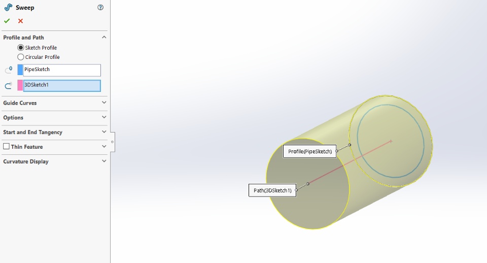

This is what my sketch looks like:

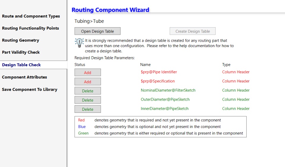

When I try to add my geometry in the routing library it prompts me to convert my pipesketch inner circle to construction geometry but this means when I extrude it shows the entire cylinder
It looks like this:

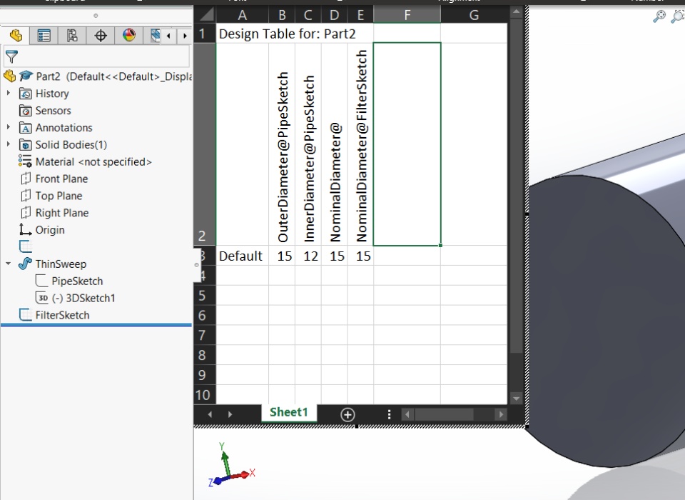

In the next step I add all dimensions in the design table
Then I add the two parameters that weren't automatically added (I don't know the relevance of these - on a side note?)
I finish updating it by naming and saving it to the database

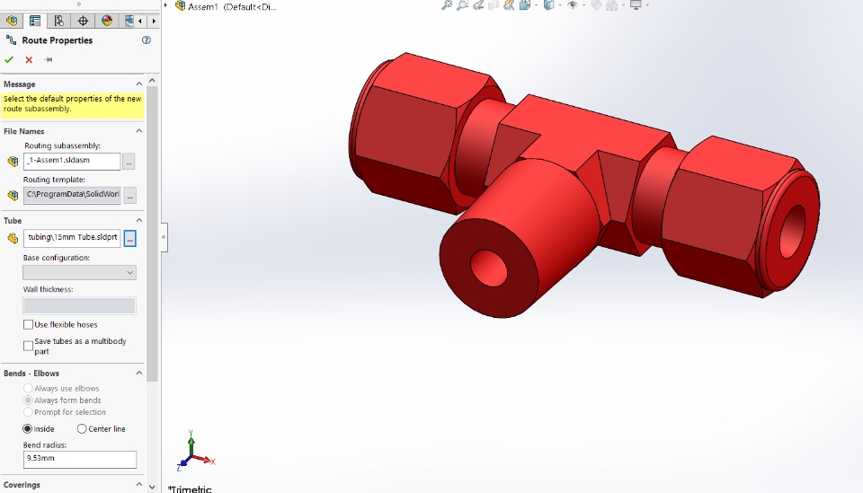

I then open an assembly and add a tube fitting like this
But when I try to use my tube in the route properties it doesn't work and none of my configurations are shown in the drop down menu

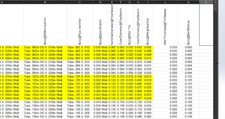

Comparing this to the ready made tube in solidworks. When I open the part, it looks like a tube for one
and the design table has multiple configurations with multiple parameters. I have no idea how to add these additional ones.
