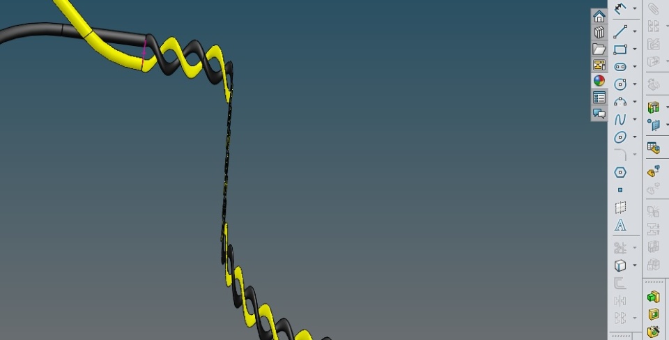

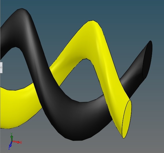

But this NEVER works out for me. See the attached images. I am just not that familiar with twisting a profile in the Sweep command (nine times out of ten I'm creating a helical curve). And when I try to use it, this is what always happens:
Neither result is acceptable. Is there anything obvious I am doing wrong/missing? Is there an easier way to accomplish this?
image 1 : profile twist is "follow path". on paper this sounds like what i want but the results are not what i expect
image 2 : keep normal constant. on paper this sounds exactly like the results that i get. the profile normal does not change with the path
