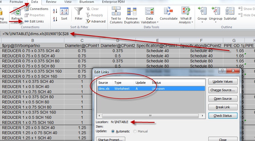

So we need to add "the rest" of the schedules for routings components supplied with the routing install. When you open the design table (in new window) you quickly realize that OD, ID, Wall thickness, etc, was originally driven by the excel spreadsheet DIMS.XLS, that apparently resided on some developers N:/ drive. (found in the excel DATA links area)
Now, I'm lazy and don't want to recreate it. Has someone recreated it or found the original?
