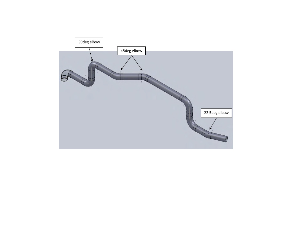

My question is how would you go about drawing a route to insert elbows, for angles other than 90 deg?
This is ok for a 90deg elbow, but to insert a 45deg elbow or a 22.5 elbow, I would have to draw two lines angled at 135deg or 157.5deg respectively (Refer to attached pdf).
Is there a 'proper' way to do this?
This only works for me when I select 'Prompt for Selection' under Bends-Elbows in Route Properties;I would be prompted to look for the part file at the particular bend.
If I select 'Always Use Elbows', an angled pipe section appears where an elbow should be.
I've compared the drawing parameters I used to model my elbows (BendAngle, BendRadius etc.) to the sample elbows in the drawing library and they all seem to be in order.
