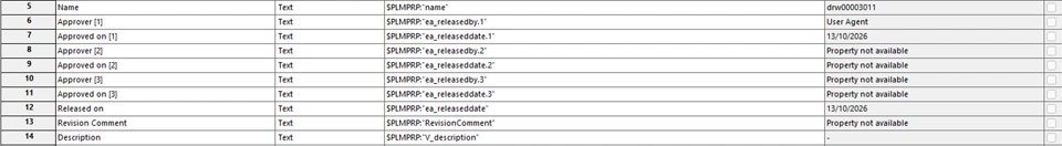

Mapped properties on the SW drawing:

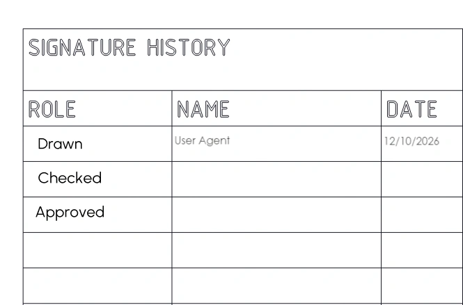

Final view on the drawing title block after completion of route
Could you help us understand what might be causing this specific issue?
