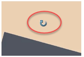

I had a problem with Rotating Sign. When I press and roll the mouse wheel this sign will appear. Normally when I stopped pressing the mouse wheel this sign will disappear but in SWX2019 this sign remains for a longer time or I have to activate any other command to get rid of this sign. Video follows.

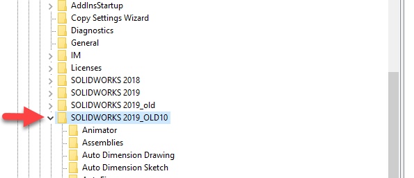

When I complaint to VAR they asked me to change SOLIDWORKS 2019 to SOLIDWORKS 2019_OLD10 in registry. Now it is fixed. Do you know what effect SWX has when name is changed?
