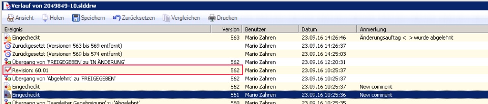

how to rollback a File in vault to the event "Revision:"? The only thing I can get is the Version but that is unfortunately not the Revision-Entry in the History of the file.
