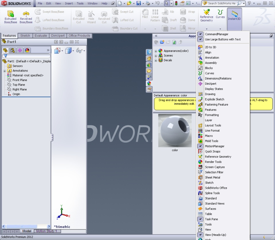

RMB shows SW toolbars Menu on top of Task Pane Add-In
Have been stuck on this a while - I have a Task Pane add-in that has some of its own context menus that are activated w/ RMB (Right Mouse Button) clicks. However when the Task pane is docked, and Auto Show is pinned, the Task pane right clicks are by passed and the SW Tool Bar menu comes up on top. I DON'T want this to happen. I see on some of the other SW Task Pane tabs that the RMB does not and does bring up the SW Tool Bar Menu. Does anyone know how to prevent the SW Tool Bar menu from coming up over a Task pane add-in? Thanks in Advance!
