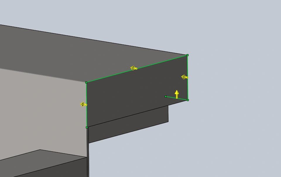

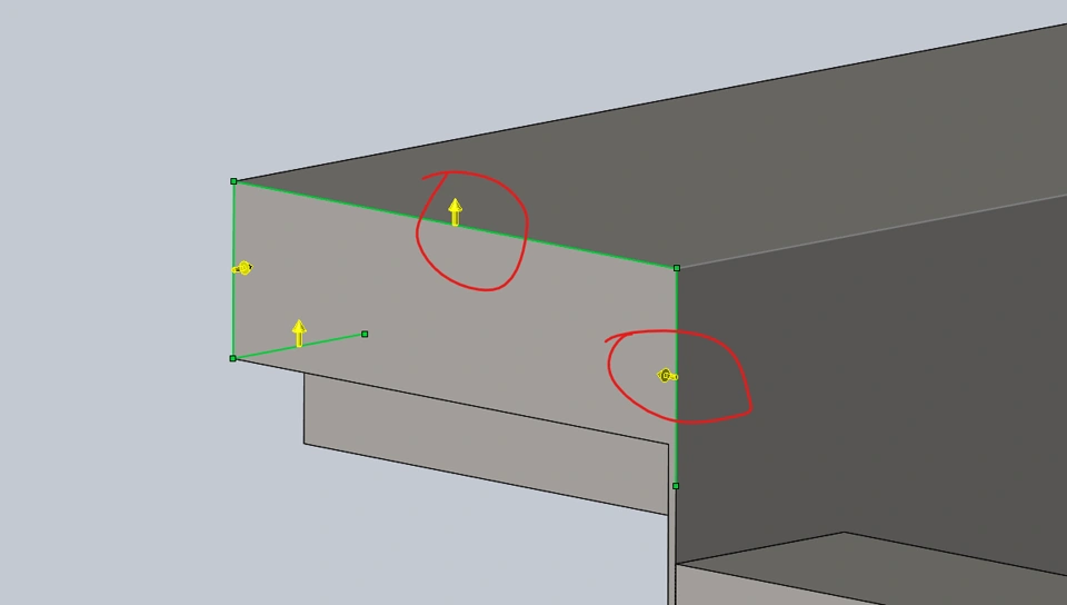

Hello Everyone,
I'm trying to use the 'rip' command, and I've created a 3D sketch for it. The 1st image below shows the rips going in the correct directions. I'm trying to rip the other side of this part, and it's the same exact shape, no difference besides them being mirror images. The second image below shows the direction incorrectly, indicated by the red circle. If you select just the edge, you can change the direction 90 degrees, but with Sketch's it does it only 180 degrees, and the same measurement does different things between sketches and edges. Any help getting the rip on the 2nd image going in the direction of the 1st image would be appreciated.
