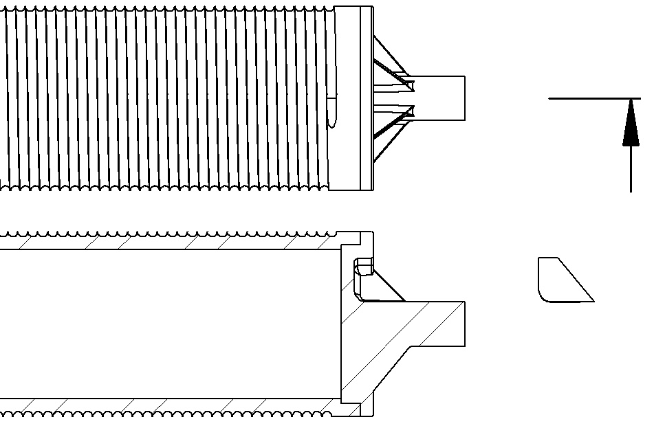

I'm trying to remove the hatch from a rib feature in a section cut but Solidworks is messing things. On the assembly drawing, when I place a section cut that passes through the rib, SW ask me to choose which rib features I want to remove from the cut scope, but it draws the cut with the removed rib hatch feature left as a fragment outside the drawing also in the wrong side of the rib feature (there is a circular pattern of 5 features around the cylindrical axis)
I have no idea how to fix it
If anyone know how to fix it I'd be glad
