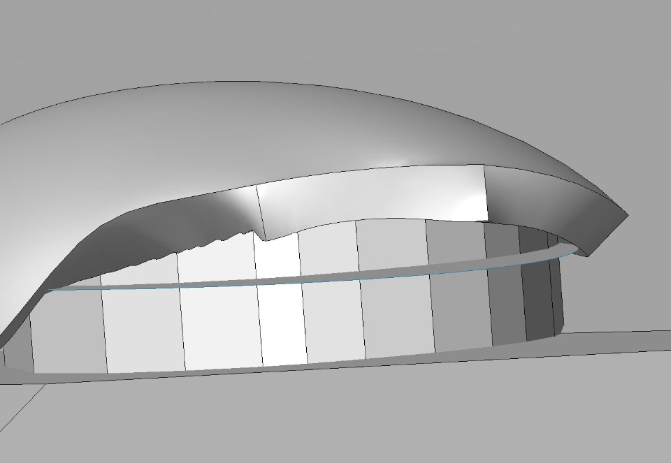

Again a new problem emerges - the pressure results in the Surface plots, can not be seen unless you click on those furfaces. But then the blue selection color is appearing as close as you zoom in the project. Take a look:
[URL=http://imageshack.us/photo/my-images/843/28110942.jpg/][IMG]http://img843.imageshack.us/img843/3153/28110942.th.jpg[/IMG][/URL]
[URL=http://imageshack.us/photo/my-images/832/68293881.jpg/][IMG]http://img832.imageshack.us/img832/4944/68293881.th.jpg[/IMG][/URL]
[URL=http://imageshack.us/photo/my-images/801/81569327.jpg/][IMG]http://img801.imageshack.us/img801/4928/81569327.th.jpg[/IMG][/URL]
[URL=http://imageshack.us/photo/my-images/153/92476316.jpg/][IMG]http://img153.imageshack.us/img153/4862/92476316.th.jpg[/IMG][/URL]
