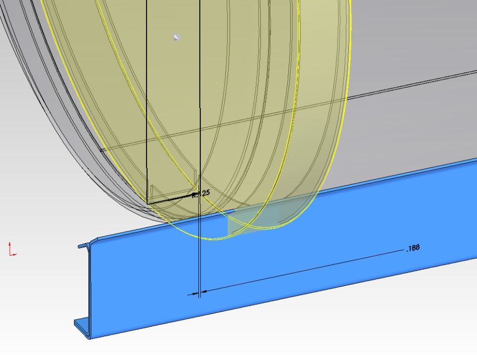

Revolved Normal Cut
Is is possible to make a revolved cut normal?  The parts I need to cut are sheet metal and they mate to a cylindrical part.  I want to use the cylinder to cut the sheet metal but if I revolve the cut, which seems intuitive, it won't allow a normal cut like I will get when producing the sheet metal flat patterns in reality.
