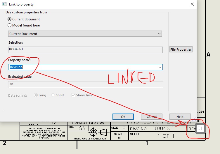

I have many number of drawing sheets and I want to update revision numbers in it at two places:

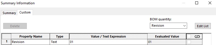

1. Revision Cell in Title block (Which are linked with Properties with "Value" or "Text" equal to "01" in all drawings)

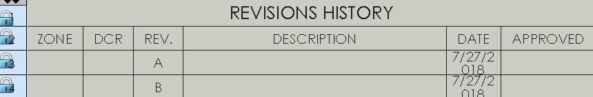

2. I want Revision Table which can keep adding 01, 02, 03 automatically.

Even though this modifications, if I add raw, it adds A, B, C...
Here is the image:
What can be done to link 01, 02, instead of A, B?
