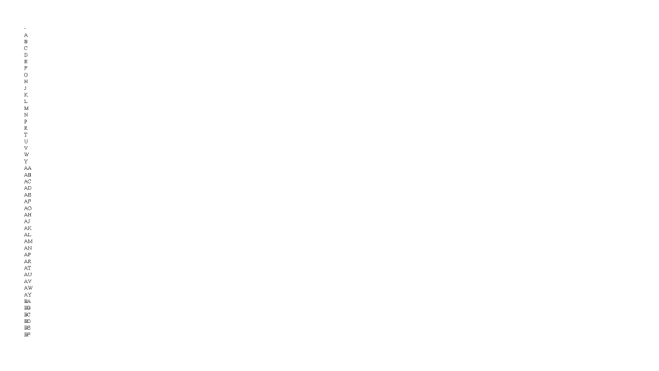

EDIT:  I've attached an excel file in a post below which has all the revisions from "-" to "YYY" following the rules above. This can be copied/pasted directly into the list box in EPDM.
