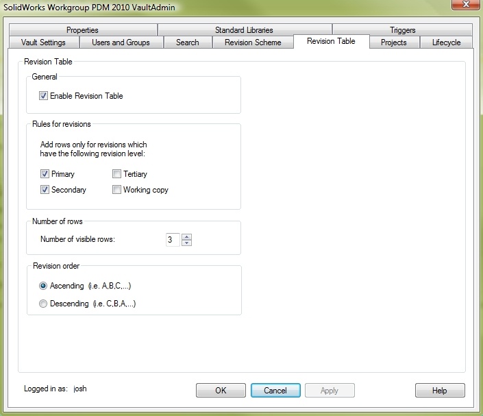

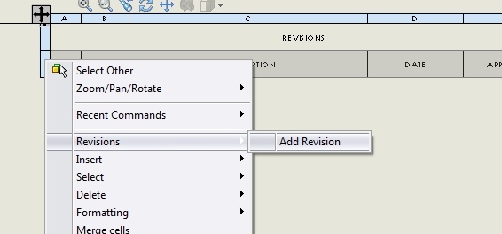

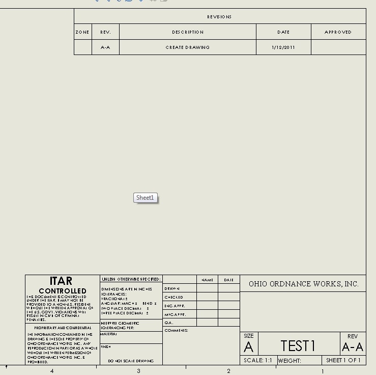

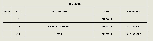

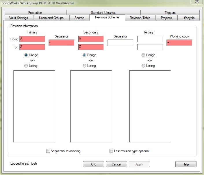

Until recently our revision scheme in PDMVault was Primary A to Z only.  This gave us 26 revisions, however in the recent past we actually made it to "Z" on a part file and need to be able to go higher.  I've changed our Revision Scheme to A-A, A-B, A-C, etc...  Now there is Primary A to Z and Secondary A to Z.  The problem is when we add a revision table to a drawing it still only shows up as A, B, C in the revision table.  Is this a system option, document property or something like that that I need to change?  Or do I need to change my revision table template (and if so, how do I do that)?
