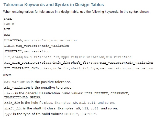

The SWX help regarding tolerances in design tables (2015 SOLIDWORKS Help - Tolerances in Configurations ) explains the format for the design table entries:
I want to make an API call with such an entry (via IConfigurationManager.SetConfigurationParams).
In that API call I want to keep all values as they are, except "min_variation".
That means, before I can make the API call, I need to collect all values (except min_variation).
"hole_fit", "shaft_fit" and "max_variation" can be retrieved via the getters of IDimensionTolerance.
The first entry (NONE/BASIC/MAX/BILATERAL...) can be found by checking IDimensionTolerance.Type and doing some case work.
But how do I get the other two - "class" and "type"?

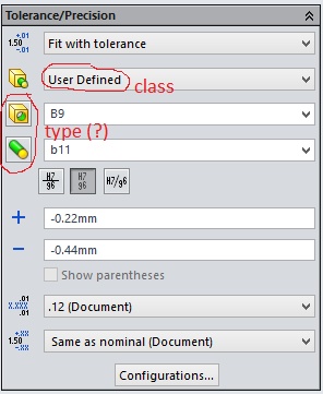

The "class" and "type" can be seen in the user interface at least:
(I believe if one of the marked icons is activated, it corresponds to type=HOLEFIT or SHAFTFIT, respectively. But what type is it if both are activated or oth are deactivated?)
But how do I get them with the API?
