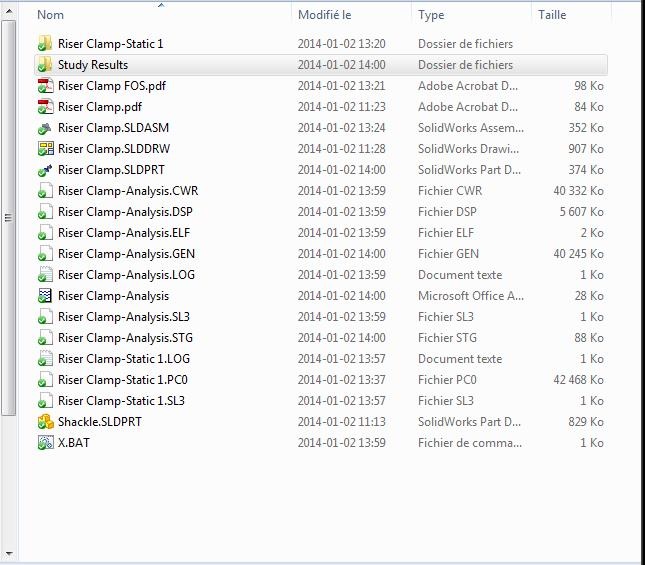

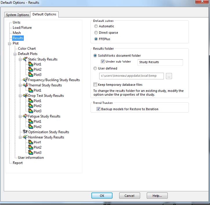

when I do a simulation, I would like the result files to be located in a folder where my part/assembly is. I will include some picture of what my settings are right now and where it currently saves the files.
under simulation > option > results
The result folder "Study Results" is created but it stays empty and all the result files are saved where my parts/assemblies are.
What am I missing so that the simulation result files are created in the "Study Results" folder?
