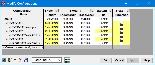

I'm trying to setup a few derived configurations from the "Modify Configuration" dialog and i got it all setup, changed some dimensions and that all works fine. However, now for a few of them i'd like to change them back to following the default (or direct parent configuration of the derived configuration). I can't seem to figure out how to do this and make the corresponding cell in the table go from "yellow" back to "white" indicating it is following the parent. I can change the dimensions individually to be the same as the default, but in the future if the default changes i have to manually update all the following configurations because their no longer linked.
How can i reconnect or reset my derived configuration dimensions to pull from the default?
In the example below i would like the "Length" of all the "-WRAPPED" versions to be the same as, and update directly with, the default 175mm
