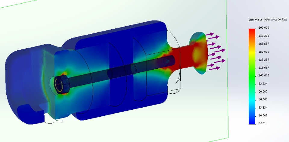

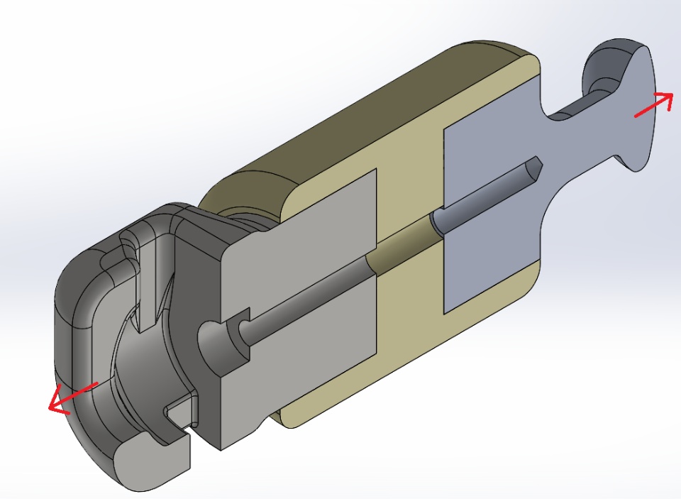

I am running a pull test on attached assembly. Imagine there is a bolt. I would like to find out what size/grade of bolt I have to use to withstand required load.
Simulation is up and running but all I can find is an axial force from bolt connector and I believe it comes from tightening, not from tension.
Is there a way of finding out maximum load in this bolt or minimum proof load required?
SolidworksSimulation
